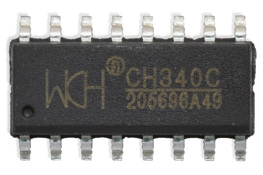

The CH340 is a chip that converts USB signals into serial communication which can be understood by microcontrollers, sensors, and other serial devices.
In the next chapters, we will be going over the instructions on how to install the driver for the CH340 for all platforms
