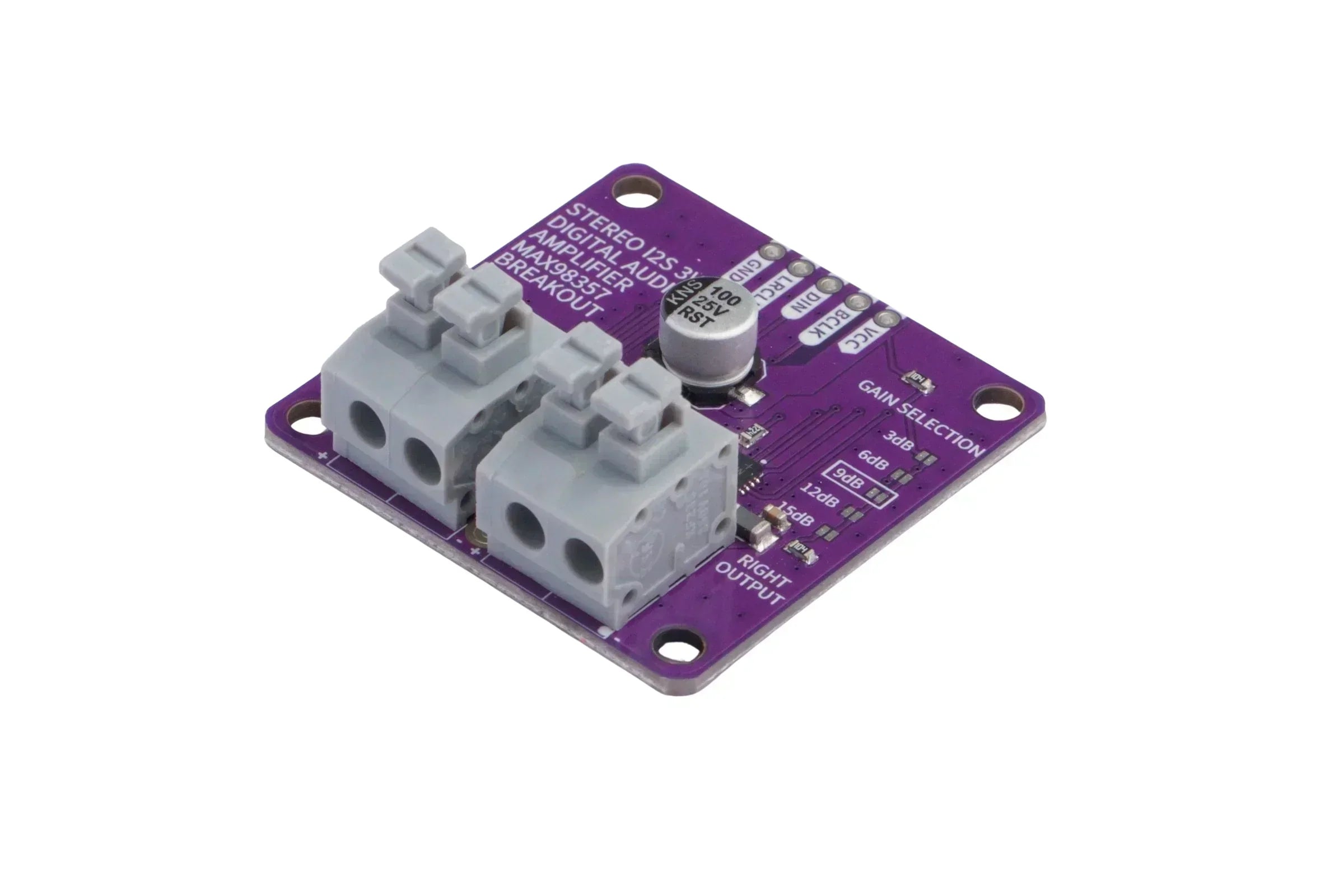

Digital sound has quietly become the voice of modern embedded electronics. Smart sensors speak, wearables play alerts, toys respond with personality, and IoT devices deliver surprisingly rich audio from very small hardware. This shift is possible because of a new generation of compact digital amplifiers that make high-quality sound simple to integrate. The MAX98357 is a prime example, accepting an I²S audio stream directly from a microcontroller and producing clean, amplified output with only a handful of supporting components.
Understanding Digital Audio Amplification
Digital audio amplification keeps the signal in digital form until the final conversion stage. The MAX98357 converts and amplifies the audio internally, reducing noise and eliminating the need for external DACs or complex analog circuitry.

The MAX98357A combines a digital-to-analog converter with a high-efficiency Class-D amplifier, allowing a microcontroller to drive a speaker directly from an I²S audio stream. It can deliver about 3 W of output power depending on the supply voltage and speaker load, and it maintains low noise, low distortion, and simple wiring that suits compact embedded audio designs.
Key features:
  • Integrated DAC and Class-D amplifier
  • One audio channel per chip
  • 3.3 V supply operation
  • Up to roughly 3.2 W output into 4 Ω at 5 V
  • Low quiescent current
  • High efficiency
  • Low output noise and THD+N
  • Supports sample rates from 8 kHz to 96 kHz
  • Breadboard-friendly modules with documentation and library support
Wiring the MAX98357 to an ESP32
Only power, ground and three I²S lines are required.
I²S connections:
  • ESP32 pin 26 → BCLK
  • ESP32 pin 25 → LRCLK
  • ESP32 pin 27 → DIN
Power:
  • VCC → 5 V or 3.3 V
  • GND shared between ESP32 and amplifier
Speakers:
  • L+ and L−
  • R+ and R−
Selecting Speakers and Audio Formats
Small 0.5 W to 3 W speakers with 4 or 8 ohms impedance are ideal. WAV files should be 16-bit PCM at 44.1 kHz for maximum compatibility with ESP32 audio libraries.
