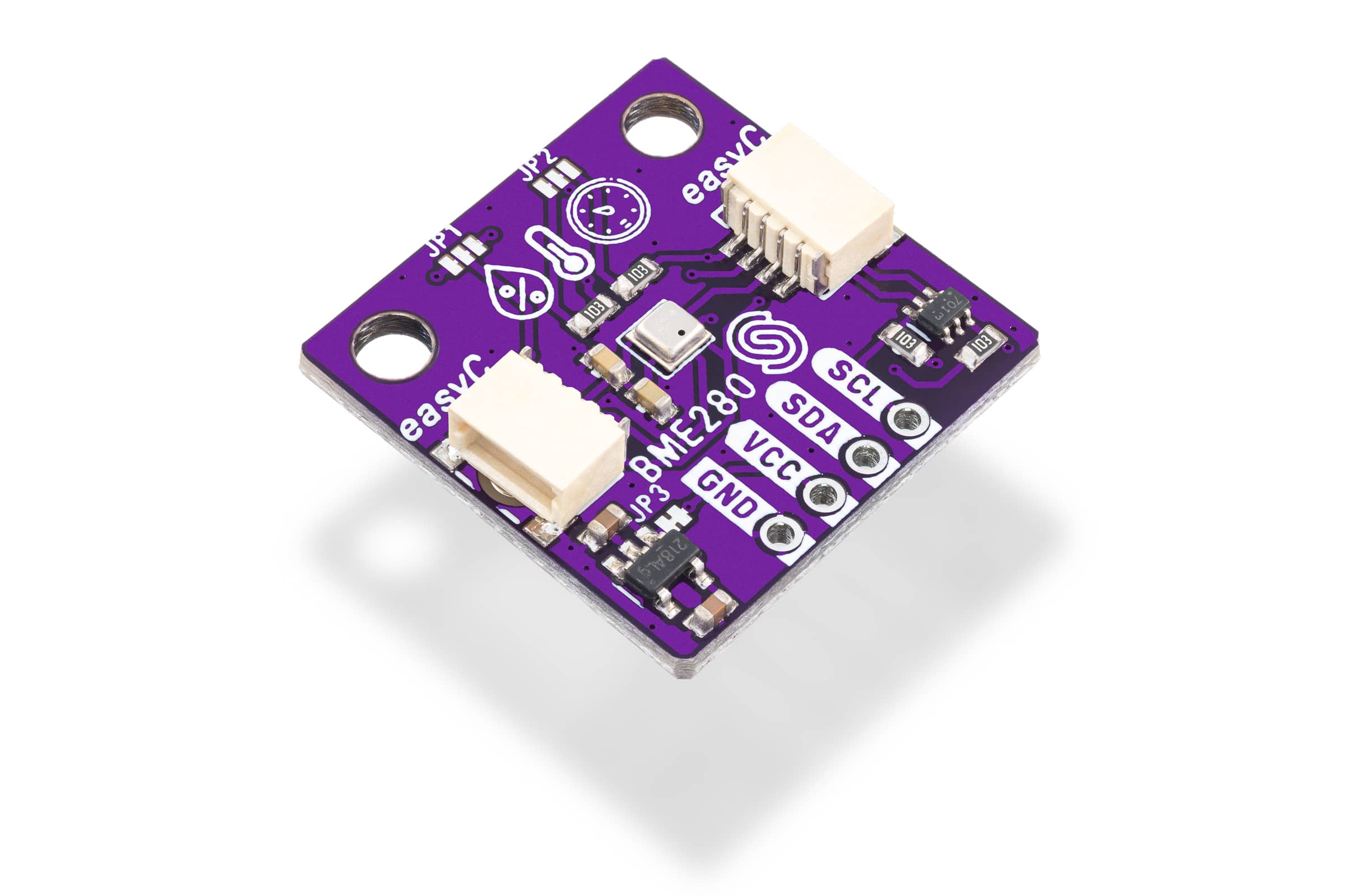

Overview of the BME280 sensor
Enviromental sensor BME280 breakout-easyC ecosystem
The BME280 Environmental sensor is an atmospheric sensor that measures three values: temperature, pressure, and humidity. Additionally, elevation can be calculated. It is simple to use since it communicates via I2C and is designed for seamless Qwiic connectivity.
 It is extra small, so it can be placed anywhere. This sensor measures everything you need to know about atmospheric conditions, so it is ideal for meteorological station projects!

  • Environmental sensor BME280 breakout
  • Qwiic cable
  • DVI cable
Connect the BME280 via Qwiic cable, and the Monitor via the DVI cable to the NULA Max.
