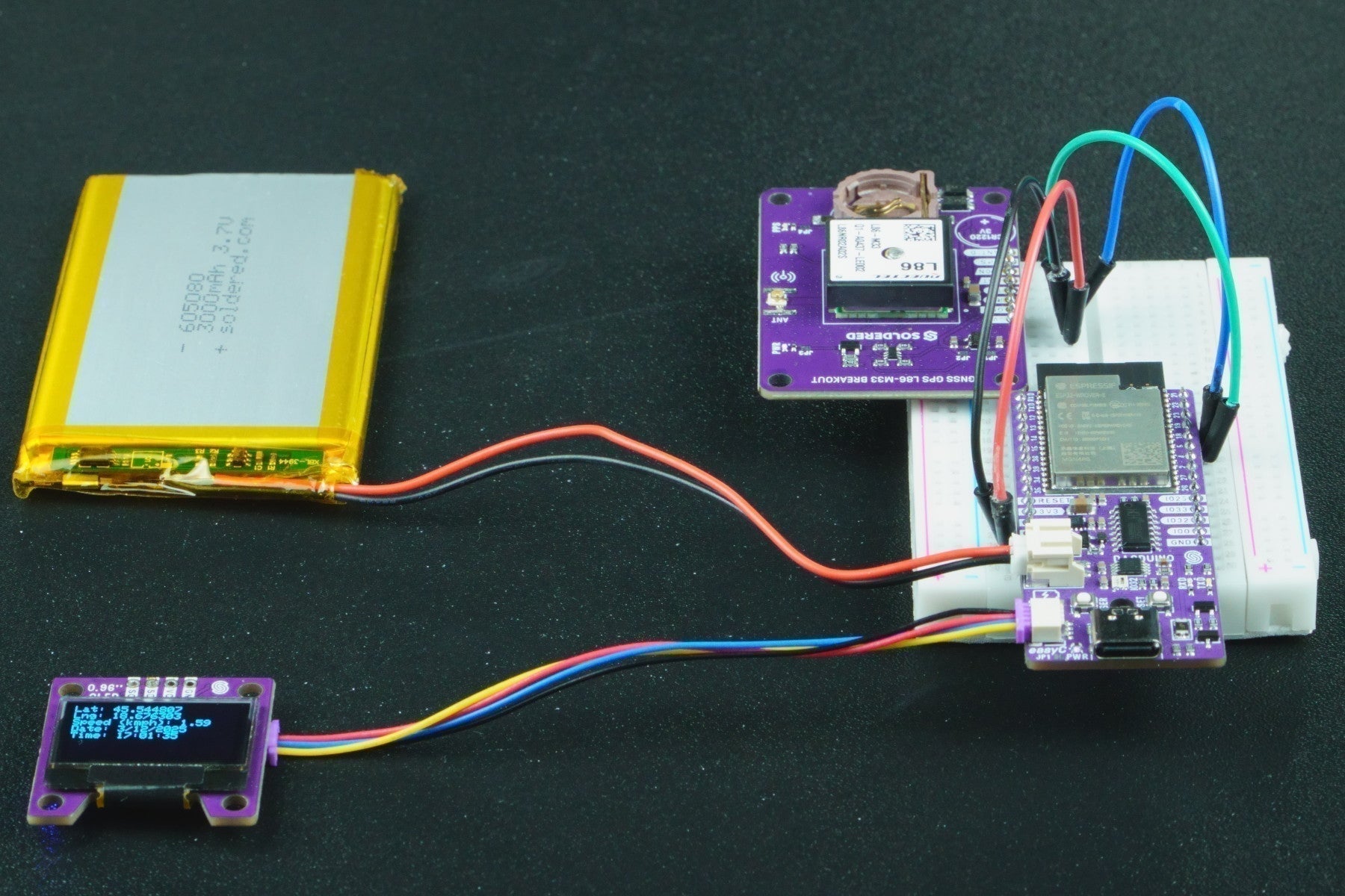

If you ever wanted to build your own portable GPS tracker - something that you can carry with you at all times to see your direction, speed and your current location - then this project is for you. Whether you’re into hiking, biking or simply enjoy creating gadgets that can be used in real life situations, a DIY GPS tracker is a fun project and a good way to explore the world of navigational technology.
Using a GNSS module, a small OLED display and a rechargeable battery, you can create a compact device that shows you real-time movement data wherever you go. This system is built using an ESP32 microcontroller, while everything is connected on a breadboard, the goal of this article is to give you an idea and inspiration to create something even more flexible and compact that serves your needs. We’ll walk you through how the systems works and how you can use them all together to build your own portable GPS tracker.

Portable GPS Tracker project
A simple project which uses the L86-M33 GNSS GPS module to accurately measure position, speed and direction. The 0.96'' OLED display is used to display data in two ways: one screen prints out the position, date/time information and speed, the other screen renders a compass showing the current direction you're moving in. Screens are alternated every 5 seconds.
Components used:
  • ESP32
  • GNSS GPS L86-M33 module
  • OLED Display 0.96''
  • 3.7V Li-ion battery
