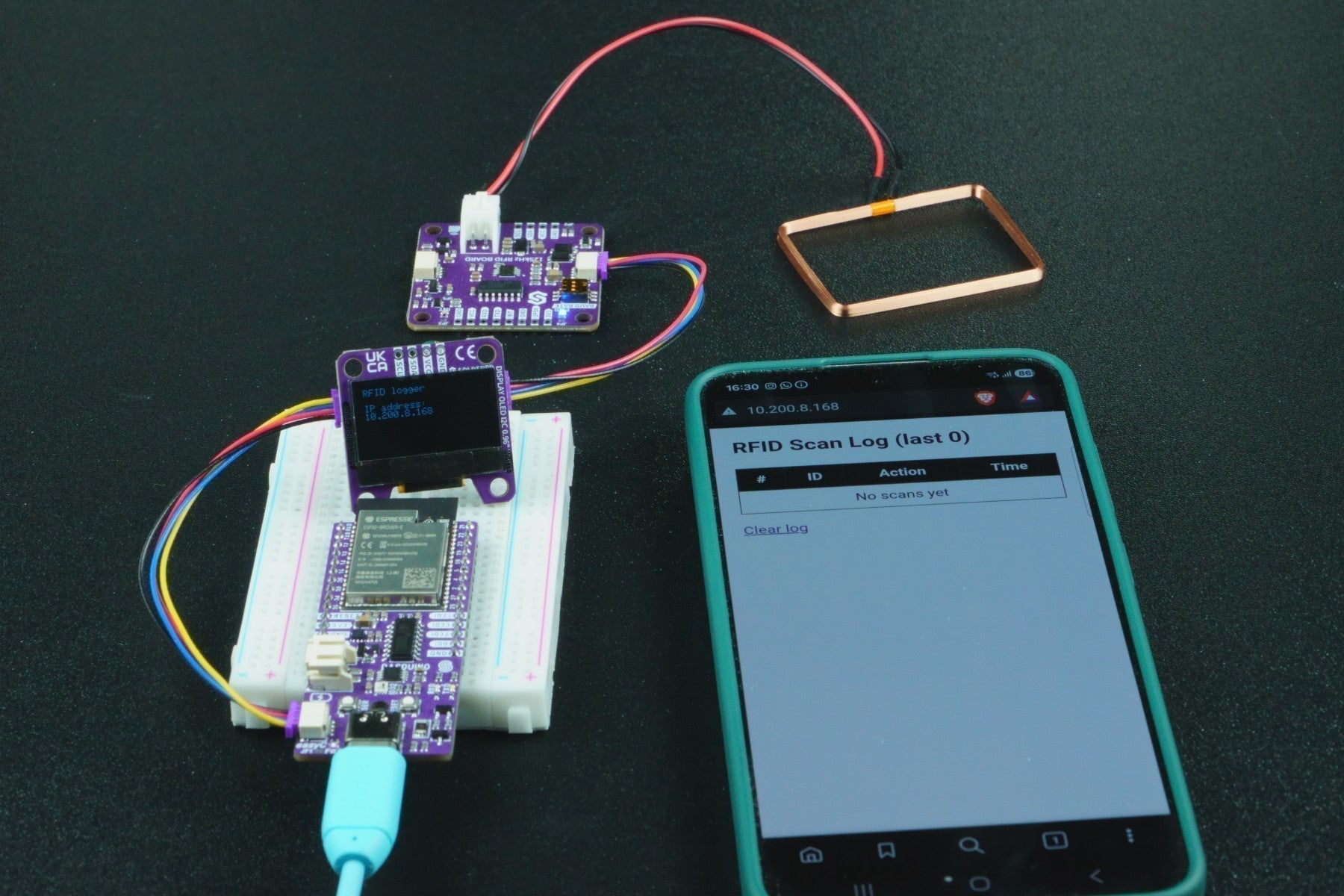

Arduino office time logger project with RFID
Now that we can easily read tags, let’s make something even cooler! Instead of writing data to an SD card, we’ll host a local webserver on the microcontroller that shows tag scans in real time.
For this example project you will need:
1× Microcontroller (we’re using Soldered Dasduino CONNECTPLUS)
1× RFID Reader Board
1× OLED display (for user feedback)
1× RFID card
2× Qwiic cables for plug-and-play wiring
When a user taps their RFID card or tag, the system will:
  • Read the ID from the RFID board.
  • Display the user’s name (or “Unknown”) on the OLED.
  • Serve the event log over a simple web page on your local Wi-Fi network.

Now, when you scan a tag, the ID appears on the OLED and in your browser at the ESP32’s IP address.
Full project with detailed code and setup instructions is available here.
