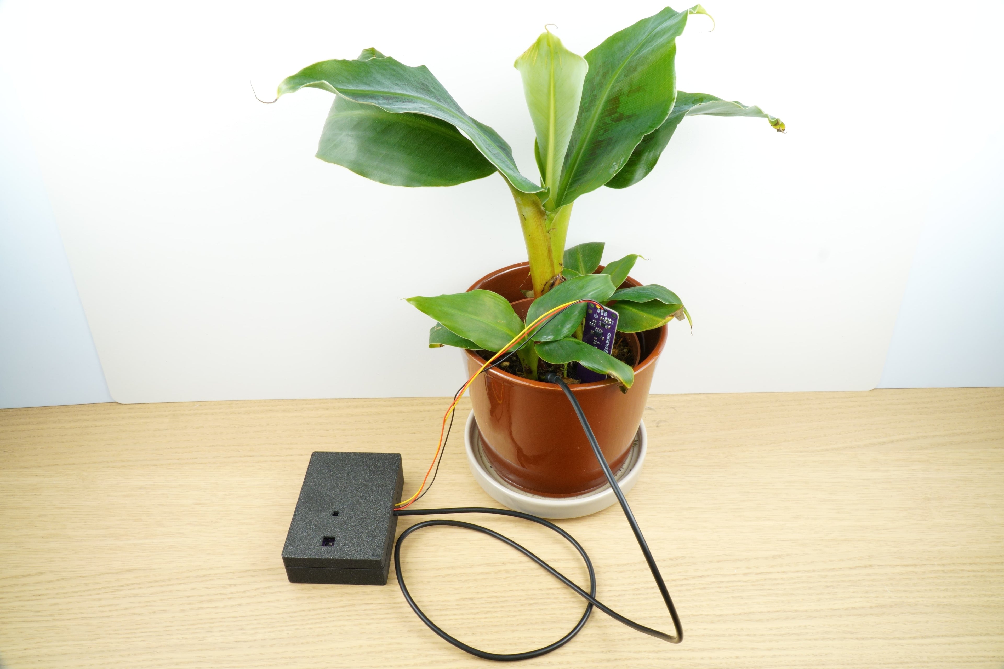

Plant Watcher is a low power IoT plant monitoring project based on the Soldered DeepSleep NULA board using the ESP32-S3 microcontroller. The system periodically wakes from deep sleep, reads multiple sensors, connects to WiFi, sends the data to a webhook endpoint, and then immediately returns to sleep.
This approach allows Plant Watcher to run for long periods on battery power while still providing regular updates. There is no screen that needs to stay on and no continuous wireless connection draining energy. The device exists only to collect accurate measurements and deliver them where they are useful.
The project is suitable for indoor plants, office greenery, greenhouses, seed trays, and any environment where long term monitoring provides insight that occasional manual checks cannot.

Hardware Overview
Plant Watcher uses a carefully selected set of components that balance measurement quality, power efficiency, and simplicity.
  • Soldered DeepSleep NULA board with ESP32-S3
  • LTR-507 light sensor breakout
  • Capacitive soil moisture sensor
  • SHTC3 temperature and humidity sensor
  • DS18B20 waterproof temperature sensor
The DeepSleep NULA board is the foundation of the system. It is optimized for low power operation and makes full use of the ESP32-S3 deep sleep capabilities. This allows Plant Watcher to wake only when needed and remain powered down the rest of the time.
The LTR-507 sensor measures ambient light levels, giving insight into how much usable light reaches the plant. This data is essential for understanding growth limitations related to placement.
The capacitive soil moisture sensor measures soil water content without corrosion. Unlike resistive probes, capacitive sensors do not degrade over time and provide more consistent readings.
The SHTC3 sensor provides accurate air temperature and humidity measurements. It is well suited for battery powered applications and reacts quickly to environmental changes.
The DS18B20 waterproof temperature sensor allows direct measurement of soil or water temperature. This is especially useful for larger pots, hydroponic systems, or plants sensitive to root temperature.

How Data Is Collected and Sent
Each wake cycle begins by initializing all sensors. Light intensity is read from the LTR-507. Temperature and humidity are sampled using the SHTC3. Soil temperature is obtained from the DS18B20. Soil moisture is measured via the capacitive sensor and converted into a percentage.
Once all values are collected, the ESP32-S3 connects to a configured WiFi network. A JSON payload containing all sensor readings is then sent via HTTP POST to a webhook endpoint.
This webhook approach keeps the system flexible. The same firmware can be used with many different platforms without modification. The endpoint can forward data to dashboards, databases, automation systems, or notification services.
In addition to regular measurements, the firmware can send conditional alerts. For example, if soil moisture drops below a defined threshold, an additional warning message is transmitted. This allows rapid response without constantly checking logs.
