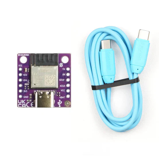

NULA Mini ESP32-C6
For makers building smart home devices, sensors, dashboards, and other connected projects, the is an excellent choice.
NULA Mini ESP32-C6
NULA Mini ESP32-C6
€14,95
€14,95
The board combines the flexibility of the ESP32 platform with modern connectivity features, making it well-suited for ESPHome and MQTT-based deployments.
Some of its key advantages include:
  • Wi-Fi 6 support for improved wireless connectivity
  • Low power consumption for always-on IoT devices
  • Compact form factor for space-constrained projects
  • Excellent compatibility with ESPHome
  • Reliable MQTT communication for smart home automation
Whether you're building a temperature sensor, energy monitor, environmental station, or a larger network of connected devices, the NULA Mini ESP32-C6 provides the performance and wireless capabilities needed to keep your MQTT ecosystem running smoothly.
