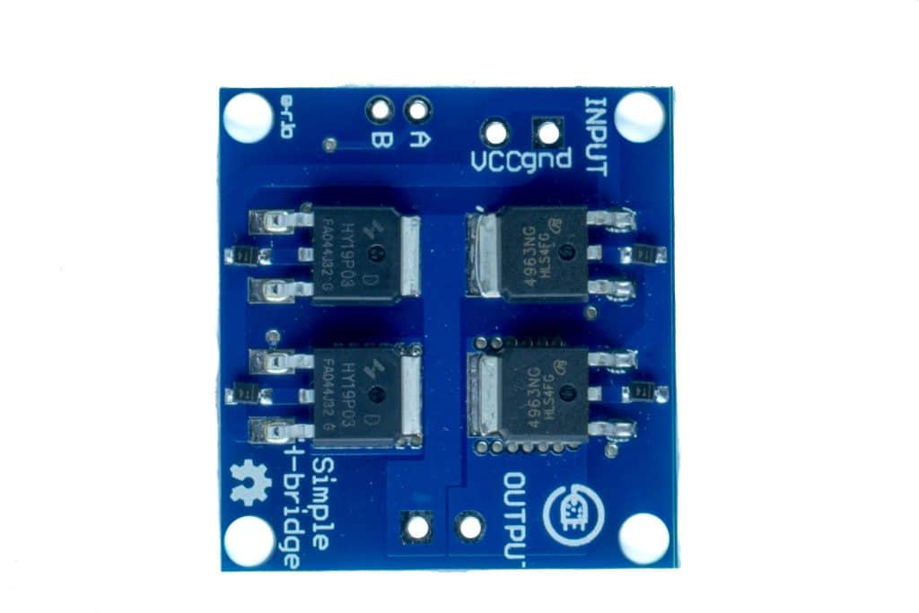

It is necessary to note that this module has only two control pins (A and B) which are used to control the H-bridge operation. A pin is connected to 2 MOSFETs (Q1 and Q2) which are actually one N-channel and one P-channel MOSFET. The reason for it is the elimination of states in which the Q1 and Q2 are simultaneously “turned on”. When the N-channel MOSFET conducts current, P-channel MOSFET does not, and it ensures that, at any given time, Q1 and Q2 are not in the same state (more about MOSFETs here). B pin is connected to the other 2 MOSFETs (Q3 and Q4) in the same way. This makes it easier to work with the module where we do not have to look out for accidentaly making the short circuit or destroying the module.

Below, we will show the connection of the H-bridge module with the DC motor whom we will control using Dasduino. H-bridge contains several pins:
VCC – Input for the external power supply.
GND – Serves for connecting minuses of the power supply.
A – Control pin for controlling the H-bridge operation.
B – Another control pin for controlling the H-bridge operation.
OUTPUT x2 – Two pins to which we connect the load (e.g. DC motor).
The image below shows an example of the correct connection of the H-bridge with Croduino. It is necessary to note that the A and B module pins are connected to Croduino, while the DC motor is connected to the OUTPUT pins. It is not important which OUTPUT pin is connected to which DC motor connector, as the rotation direction will be determined in the program.
